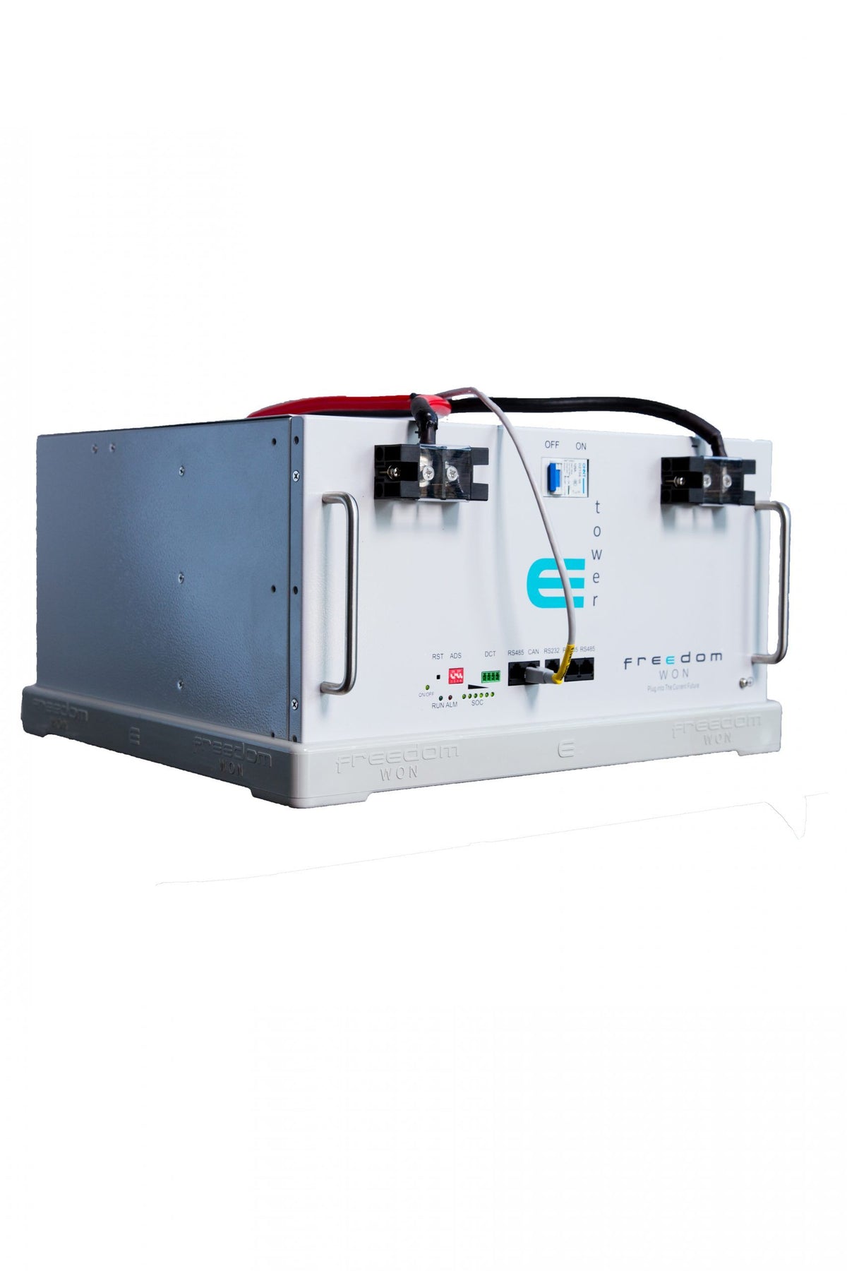

I Currently have the growatt 5000 ES Inverter and freedom won tower e5000 battery. With bms cable connected to it. 8x 575watt longi panels.
I Want add more battery storage, but the freedom won batteries about 18k each. I was thinking adding 2x these
Should I risk it? I Don't think I will be able connect to bms, them as they different brand?
So I might need run them as dummies and no bms cable going to them?
They should keep in sync all same voltage?
Terrible idea long term to forego BMS to save a few bucks.
Also could mean you have little to no warranty cover.
But the link doesn’t work.
You can't. Different BMS's. You can't even mix different sizes of the same brand, unless their BMS specifically allows it.
As @SauRoNZA said you will probably void your warranty on the batteries by running it with no BMS...

You WILL void your warranty mixing brands rather save up and buy another etower later on when you can afford it. And mixing different brands might shorten the battery life because of the different voltage settings they have
If you have Lifepo4 batteries with the same number of series cells, they can be run in parallel - the internal BMS's will control the charging, discharging and cell protection. The inverter just needs to be set to the correct charging voltage, and both batteries run un-comm'd.
The main risk would be should if a BMS should fail on one battery, and create a current sink for the other. So each should be fused to prevent that. And you'd like the batteries to be at the same voltage level when connecting up initially...
Have a chat on powerforum.co.za - lots of clued up folks there.
And yes, I'd imagine warranties will be up for discussion if something fails - even though there's nothing fundamentally preventing this implementation.

I would spend the extra on the FW they are good quality.
The sizes don't matter - the voltages just need to be the same, and the battery chemistry. Given the way the Chinese are driving down the cost of LIFEPO4 batteries, it makes mixing and matching very attractive. Esp if you're trying to find another 5yr old model from a known brand - it's going to be so much more per kWh.
All batteries have a bms going without coms is not a problem
No coms does not equal no bms
Coms is overated
Especially if your bank is big enough to run overnight without dipping under 20%soc
Yes you can mix different brands and capacities ie 5kwh and 10kwh no problem
Like others have said as long as you match the voltage
So if you have 15S 48v batteries all must be 48v
Or 16S 51.2v all 51.2v
Have 2 batteries running like this 1 has coms the other runs as dumb/self managed unit
the built it bms protects it from going oug of range
It just suppliies half the power and takes half the charge current
Parralel self balances
Really not a big deal
You can mix batteries of different sizes as long as ALL the following are true:
They are the exact same chemistry and cell number (no you cannot mix a LiFePO4 with a NMC)
Each battery has its own bms that balances (cheap ones don't self balance. It is a braai waiting to happen. You don't need coms)
Each battery has its own physical fuse
You have reasonably thick cables to do the parallel connections (good bet is same gauge as the wires coming to/from the inverter)
You could parralel lifepo4 and nmc
ie if you use a 13s nmc and a 15s lifepo4 and use voltage range that works for both
The worst that can happen
LIfepo4 will do more of the work in the upper voltage range
And the nmc more of the work in the lower voltage
The reason you would not want to do this is that you would run the one battery below the 20% more regular than others
If the bank is big enough that you never let this happen you could happily mix nmc and LIfepo4
Some Marine users do exactly this though they mix lead and lithium
So radios etc can still function in lithium trip scenarios and for cranking amps
