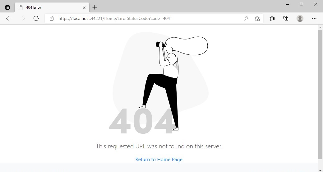

Hello everyone. I am still digging through issues with an MVC project I have. I am able to get an 404 page displayed when navigating to an incorrect url.
However any exceptions thrown and I still get a 404 page instead of my 500 page. Both the 404 and 500 are pages I created with some prettier styling.

As I said, every single error I can produce always results in a 404 error even if I flippn switch the database off entirely, still 404. How would I get the Exception from the pipeline?

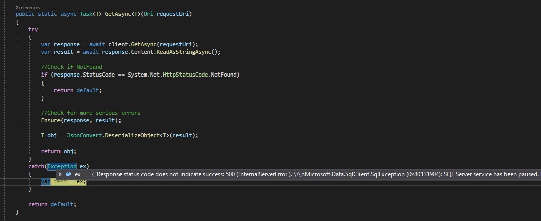

Providing more information. I have wrapped my Service caller (MVC side) in a Try Catch block (It's not there by default)
This is the error I get from a Paused server after trying to login.
Still a 404

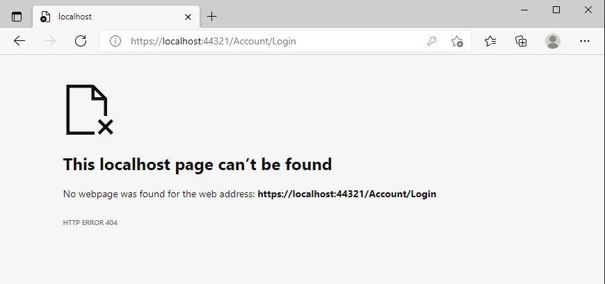

The login page is the hint to the problem.
Nvm it's probably because I was screwing with the project so much trying to figure out what was going on. This is how I have it setup after ditching all the breaking changes. Trying to login into the api that is offline. In fact ever single exception redirects me to this. It must go to the 500 page I have in place but after 9 hours of struggling, I am simply out of ideas and tired now.
