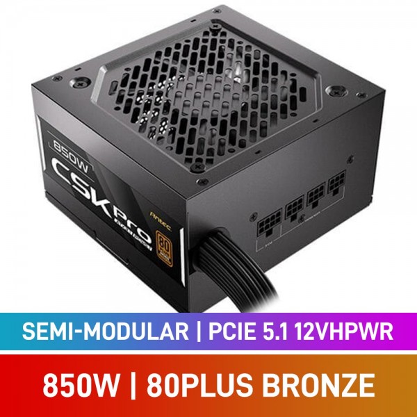

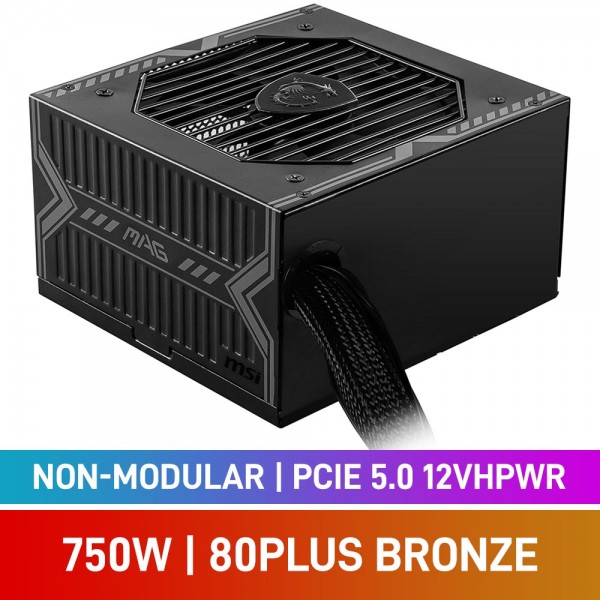

Which power supply brands should he be going for? He said the MSI MAG is trusted and 650W would be enough for a 5060.
The Antec one has a higher power rating but my son keeps going on about this bible spreadsheet where he said it was poorly rated.
Bronze will be fine since his dad will foot the electricity bill and he's unlikely to run a 5090 any time soon.
The thing is with PSU's you want overhead, 150watt to 200watt. Always get a little overhead, a PSU that runs 60% -70% load is better than a PSU than runs at 80% - 100%. Take the recommended PSU and add 100-150 watts over and above what you need.
Like this ( the OEM is helly, really decent OEM that has been around for a few years) The 7 year warranty doesn't hurt either. Given the 5060 and future expansion this would be my next choice. This is ideal because of ATX 3.x support., the other PSU is older ATX specification not really suited to modern GPU's to be honest.
PSU lists are great guidelines but they aren't always 100% up to date, PSU manufactures do revisions of their products from time to time. Yes antec do have a little bit of a hit and a miss with their PSU's, either one is pretty solid for a low power GPU anything above that look else where.

FSP is a good brand as wel, if you are happy with it being non modular. It is pretty decent. It is a C tier. I wouldn't run a 5070ti on it for example, but XX60 class card no issues.
FSP has lower quality components, antec is honestly the better bet, I didn't consider the FSP because it is a lesser quality PSU still decent but you can do better.
Antec is ranked higher between B and C tier. Both have 5 year warranties. Personally the antec over the FSP.

If the antec is out of the question
MSI Mag will also do just fine, only really difference between ATX3.1 and 3.0 is a change to the HPWR connector. it is backward compatible.
