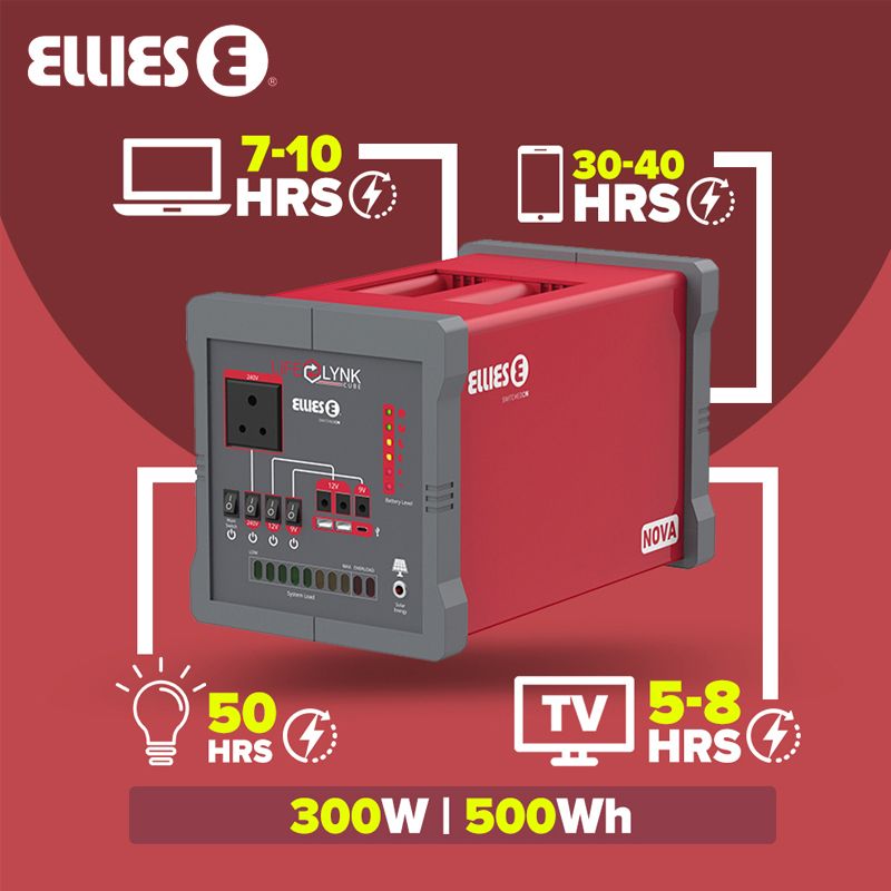

This seems like an incredibly good deal
Ellies 300W ,500Wh LiFePO4 PowerStation for R3499
What's the catch here?
EDIT: after some checking, it seems there are some downsides to this unit.
Looks like it's Modified Sinewave.
