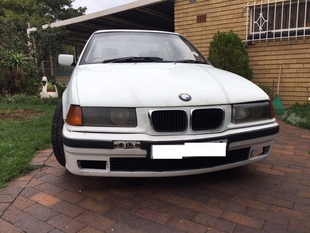

Before
After

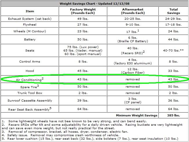

here is the part weights from e36 parts - I want it as light as possible

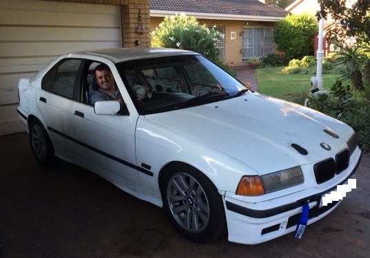

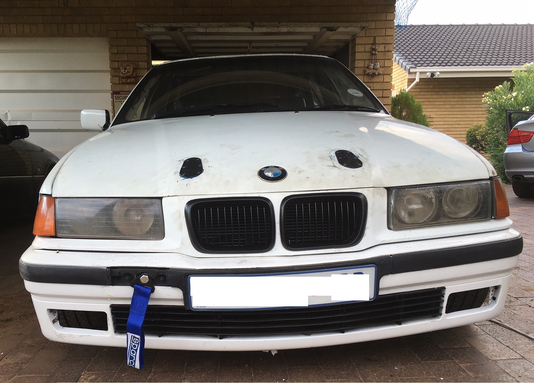

Hood Pins are done !!!
Also sprayed the grilles black and sprayed the tow hitch area where it was missing a beading cover black to match the rest of the bumper also installed my sparco toe straps
Before:
After:
Needs a wash despirately but a few more things to do hopefully tomorrow I can do an engine flush with new filters and plugs

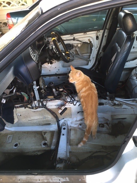

So my plan today was to do some weight savings. Tachometer and clock
Following has been removed
Back seats
Door panels
Carpets
Boot plastics and covers
Dior plastics inside the car other than the dash
I still need to remove the excess wiring. Fan blower and heater core and sound deadning mats
Easiest way I found to remove the carpet is to cut it in half. Basically straight down the center from front to back. I used a steak knife to poke the carpet and cut in a line. Worked really well. I cut around the acc pedal and heating system. I left a small piece by the heating system as I am still going to remove the heating system and the mat will come right out
Found so much human slime in this car. Fake nails. Sticky carpet and pillar covers. Matchsticks. And really dusty and dirty
Here are pics of the carpet cut

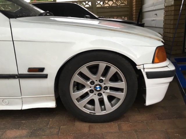

I have been putting this off but this up coming week I will be fitting my coil overs and replacing my left side rear hub as it has a broken bolt. So that will sort out the ride height
Still waiting for my lexan windows
Here are more pics from the weekend

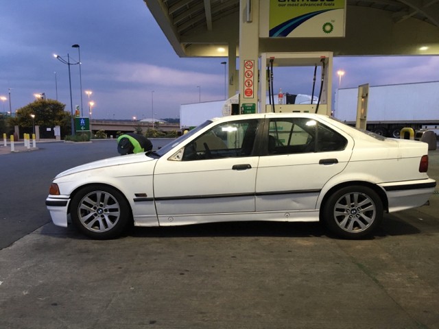

15-02-2016

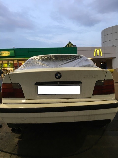

Finally Went in for the Lexan Windows

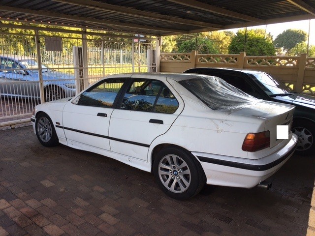

Lexan Windows installed for rear windscreen. Rear quarter window and rear windows They were Permenantly screwed into place. Check how the car lifted after more weight was removed I had a four finger fender gap lol
Roof sealed
I gave the car a rip and I can definitely feel the difference on pull off. I still have a lot of weight saving to do. So keen to see the final results
