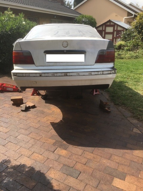

How I jacked up my car lol having a beer boep doesn't help lol
