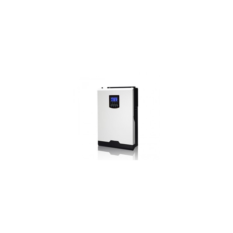

You are right about the inverter change, cheaper than a stand alone MPPT, a recommendation would be awesome, and if it can mix grid, battery and solar that would be a massive plus.
Yeah Its a no brainer. Recommended panels to go with that? I wonder I configurable it would be in terms of customisation.
It's not expensive enough to mix grid and solar, but it's a great package that gives you other capabilities.
There's the one I posted above and the same thing from Solar UPS Electric, I bought an MPPT charge controller from them some time ago.
The MPPT range is 30 to 80V so It's a tricky one to maximize for the voltage rating and good current for charging.
I would suggest 4x 250W, two connected in series for about 60+V and connected in parallel to the inverter for just under 20A.
You can play around with combinations that gives you the best current but still falls within 30 to 80V.
Edit
So why does this thing that I have cost more than double that one?
Because you didn't come ask here first
It’s the current UPS. They are still selling for 12k although it was obviously less 6 years ago. I know it’s modular but have no idea why it’s double the price or more of something like the link you sent me.
12k! WTF! You can get a Axpert King 5kW that blends grid power with solar for that price. Another 8k and you can get a sunsynk that can feed into the grid.

There are other options of MPPTs, so you don't have to buy an inverter if you can buy a cheaper charge controller. I bought the Epever Tracer, the 30A version, you are going to get at most 20A from your panels so you don't really need a 50A controller. It has an LCD screen so you can see anything that's important to monitor.
The MPPT range is 26V to 72V, mine has a maximum solar power of 780W so maybe look for the 40A version, it has 1040W max for solar.
Thanks again, this seems to maybe be the better option. Tempting to replace the inverter etc but prefer an easier modular solution I suppose . Excellent.
Or maybe just do two panels or 330/360 each? Seems the easier choice probably
