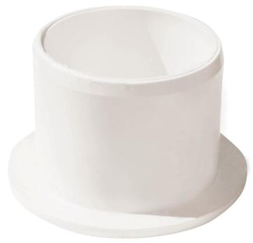

I am bit immobilised at the moment but was hearing crazy things when the pool pump was running over the last few days. I went to wier and saw that the pool lost 3-5cm of water since the last time I looked at it. Ironically, I had to replace the weir cap as it was cracked .
I’ve looked at the solar heating , the pump and weir can can’t seem to see anything leaking. I can’t see if the it’s going to the backwash as the overflow goes straight into sewer (don’t ask - it’s the only way to do it considering elevation / gradient of property ).
Can’t see what’s happening in the pool as it is covered and I can’t remove it.
Could the pump selector (backwash / filter/circulate) have given up the ghost? I’ve been here for 5 years now, and have never changed it. Just wondering if I can solve it cheaply first before calling a professional.
I would look at replacing the spider gasket in the pump selector first. R120 and very easy to DIY.
We had the same problem. Losing water while pump was running. Turns out spider gasket was worn and not seated correctly anymore. So steadily lost water down the waste pipe while pump was running on filter.
