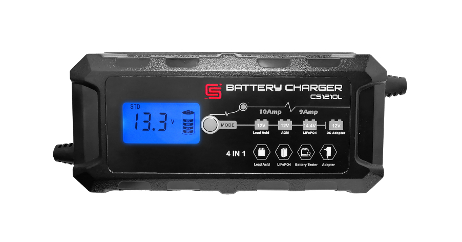

Now if you plug in a 30A wall charger to the LFP so that it can charge the battery whenever Mains are on it can work as a nice workaround to not use the Eco's batteries much?
