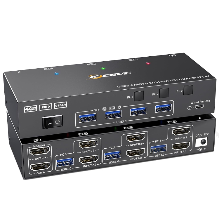

I have one of these...
Was meant to switch between my personal laptop, work laptop and gaming PC. However, the gaming PC is currently on hold...
in the meantime using one of these
i can run my S23 FE in Dex using my mouse, keyboard and headset or external speakers. You dont get extended display... it will show on both displays but mirrored. Not a big deal for me tho.
