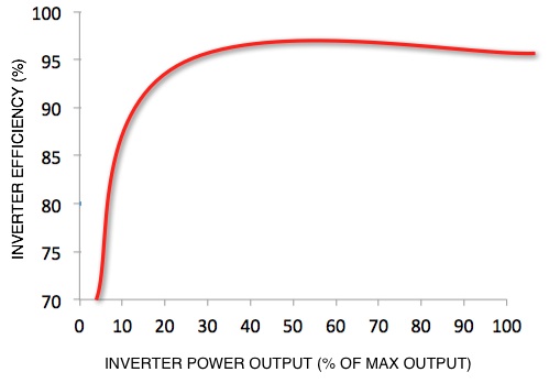

Efficiency curve chart for the inverter (snarfed from the manual)

What is load rate?

A load rate of 100% would mean you're pulling 8kW out of an 8kW inverter.
Most will sit at loads of 10% or less for the majority of the time, then peak when larger ticket items turn on and draw power - eg Geyser etc

Looking back to the inverter ratings, you'll often note a few values. Max, Euro, MPPT. These relate to the different parts of the system (MPPT for MPPT efficiency), or for Euro and Max, the inverter efficiency.
The various efficiency ratings for the Deye/Sunsynk/whatever other rebrands that Deye claims to run at are:
  • Max. Efficiency - 97.5%
  • Euro Efficiency - 97.3%
  • MPPT Efficiency - >99%
I know you're going to ask next what the differences are between the efficiency ratings, so I've copy and pasted below. Essentially the TL;DR is that Euro (European) or CEC (US'ian) are blended ratings, Max is the best efficiency capable from the inverter. For obvious reasons, our typical comparison will be Euro efficiency, as we don't run 120v.
The longer version (Snarfing from the internet, as I'm lazy) -
Inverters have what is called an ‘efficiency curve’, usually displayed in a chart that shows how efficiency fluctuates with the input power or voltage fed into it. Each brand and model of inverter has its own efficiency curve.
You may encounter the following terms referring to efficiency when looking for an inverter: peak efficiency, Euro efficiency and CEC efficiency. The difference between these is explained below.
Peak Efficiency​
Peak efficiency indicates the performance of the inverter at the optimal power output. It shows the maximum point for a particular inverter and can be used as a criterion of its quality.
Simply put, peak efficiency is calculated as DC input to AC output when the inverter is operating at (usually) its rated capacity. For some of the best inverters, the peak efficiency can be up to 99%. That sounds pretty impressive, but remember that although this is a noteworthy number, it is not the final word on inverter efficiency. Your inverter may only operate in its peak efficiency range for a very small part of the day or not at all. This is why the CEC and Euro weighted efficiencies have been developed. They recognize that inverters don’t always operate in optimal conditions, and instead these measurements offer an indication of how an inverter might perform throughout the day.
European and CEC Efficiency​
European efficiency is the weighted number taking into consideration how often the inverter will operate at different power outputs. It is sometimes more useful than peak efficiency as it shows how the inverter performs at different output levels during a sunny day.
California Energy Commission (CEC) efficiency is also a weighed efficiency, similar to the European efficiency, but it uses different assumptions on weighing factors.
Euro efficiency and CEC efficiency are both ‘weighted’ efficiencies. In calculating them, the efficiency of an inverter at different spots within the operating range are taken into consideration and balanced against each other depending on importance. These measures are generally more useful than peak efficiency because they measure inverter performance across the range of the inverter’s capacity. This gives you a fuller picture about the inverter’s operating profile over the course of the day.
In calculating CEC and Euro efficiency, instead of looking only at how efficiently the inverter functions at its power input ‘sweet spot’, calculating weighted efficiency requires first selecting a few DC input levels relative to the inverter’s rated capacity.
