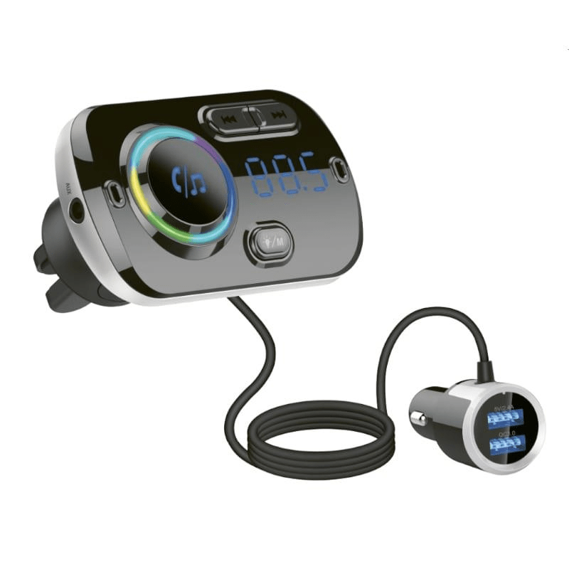

E90 owners - how do you listen to music if you don’t have idrive? Anyone fitted something aftermarket?
Works like a charm.
Gizzu Bluetooth 5 Dual Handsfree Kit - BC49BQ​
I use in my peugeot.
