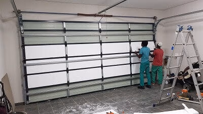

Anyone install insulation into their aluminium garage doors? What type did you use and what difference did it make in the temp? I was thinking of trying the ceiling insulation, and just tucking it into the panel.
Go with isoboard.. will be a lot simpler to install..
Haven't used them, but looks interesting.
That's interesting. Is this the reason my garage is so hot. Sun doesn't hit the door except for a short period in the morning. The side wall and roof (on which solar panels are) get the heat. The roof has thickest aerolite possible. My garage was previously wooden door and now AluZinc but the temp has always been very hot - I don't think it changed. Wonder if this could make a difference (probably not)
My garage door gets sun the entire afternoon. You can feel the heat radiate of it. Ceiling is already insulated, so that's my only option to reduce the temp in the garage.

My step father has polystyrene boards cut to size to install between the roof trusses, and a ceiling. They just sit loose, and held up by strips of wood that are screwed into the trusses/beams (strips are wider than the beams)
This is for me :thumbsup: or maybe Isoboard as suggested by @WAslayer.
