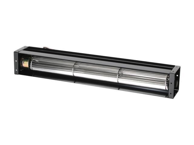

If you guys have space on your motherboard tray for this, then it is worth more than having many 12cm fans:
http://c1.neweggimages.com/NeweggImage/productimage/00-887-011-03.jpg
Cooler Master STF-B01-E1. Cut a hole in the tray and mount this on it. It'll flow air across the motherboard as well as under it.
I just broke my one about a week ago. It's now R300 or so which is 3x what the original cost 5-6 years ago.
:D
Tube fan, about 34cm long, motor is on the top. Motor can be a bit buzzy though. I had it in my new rig about 2 weeks ago, but the bearing ofcourse has become noisy over 5-6 years so I removed it. Northbridge temps now noticeably up.
:D
Buzzy? Not cool...
The cap buzzing on my GPU is bad enough...
It was quiet for many years. I think I messed it up somewhere along the line (dropping it, etc). I must actually look around for other ones like it. I'm sure it is not a unique piece of kit.
It r true :D
I just went to dig the fan out the bin and have another look. The fan part is supported in a bearing housed in a anti-vibration rubber mounting on the one end. Seems that bearing is the one that actually got noisy. Pity it broke after so long. :(
