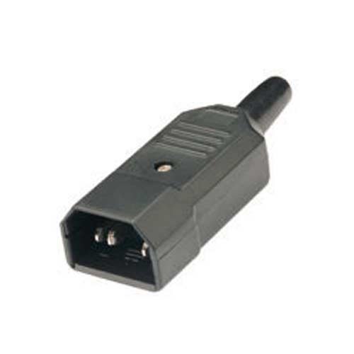

I chop off a multiplug's 3 prong and solder it to an IEC connector plug - then plug everything into the multiplug :)
I get we in South Africa and "maak 'n plan" and all that jazz but how has no one made these things any sort of commercial capacity?
Ugh my soldering skills are not what they should be :(

How do you go about plugging 3 prong and 2 prong devices into IEC connectors?
So our UPS actually has a three prong plug at the back (sorry for the mess, it's in a space where we don't clean often coz of all the cables). We just attached a multiplug to that.
