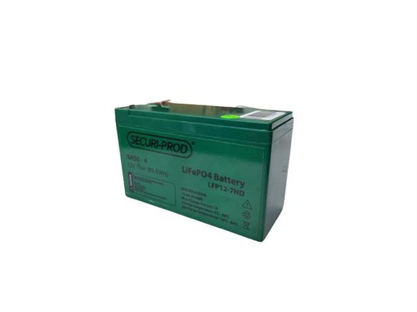

Hey folks, bit of a ressurect but on a side note my damn D5 EVO battery is now dead and I want to do a lithuim replacement. I can't seem to find the normal ones and this has mixed opinions?
Lots of other sites say its the right one with up to 10A discharge but Geewize are saying its only a 5A discharge? I'm sure they had others at one point ( fosgate, vestwood ) but everyone seems to be de-listing them.
Communica has the same battery but its higher?
Has anyone uses one of these in a D5 Evo ( non-smart )? I need to check my gate settings but I think it does show me the amps as well in the limits and that sits at around ~3ish so it should work but will check that later today
Damn, checked my limits now and its reckoning 11amps, not 3.
Not sure about these, they have a 7ah and a 12ah version, same dimensions but can handle the higher current.
But would it be safe to say stay on the 7ah? I mean a normal SLA battery thats a 7ah can only output so much although the spec sheets don't seem to list exactly what whereas the lithuims do.
Otherwise I can go for the higher lithium in the same family, should definitely handle it all, can discharge at 14A and has nearly twice the capacity same form factor, just not sure if worth the extra cost.
For the price of the 12Ah from Redpole I would get two 7Ah from Communica and just rotate them. The problem is the charging time for the 12Ah especially when stage 6 is upon us.
Well I just bought six of the 7Ah batteries from Communica and I 'think' my gate motors are either D3 or D5 but not smart. I'll let you know.
The LiFePo 7AH batteries I installed in my complex centurion D10 gate motor have worked flawlessly over the last 6 months of loadshedding including a stage 6 - bought them from GeeWiz

Not sure how the securi-prods fair in a D5 Evo but I have a Blue Nova in mine and had to reduce the gate speed a few notches from MAX to get it to work.
It has been working fine since Dec 2021, with Lead Acid I would have probably had to replace it a few times in this period.
