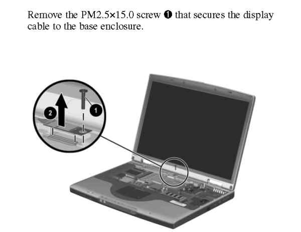

That looks like the ribbon connector is loose from the main board... there is a ribbon like connector on the back of the screen itself... this might be the culprit. It is a relatively simple thing to slip back in, but quite a monster of a task as it involves removing the entire LCD screen from the lid and carefully sliding the pins pack into the socket securely. The connector usually lies behind the actual LCD screen itself.

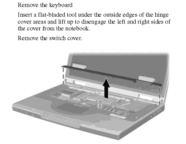

Yes, don't be scared
Just download the service manual from HP's site and follow the steps taking it apart.
