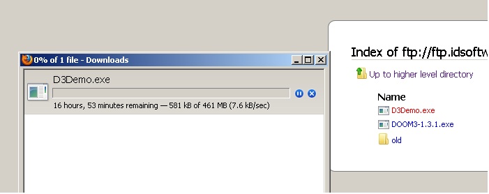

so pretoria should be cool now ? also getting very slow speeds and i'm currently on just @mweb as @dslmweb gives same result.
file used for testing
ftp://ftp.idsoftware.com/idstuff/doom3/win32/D3Demo.exe
@dslmweb
I can't see anything wrong with that trace Necuno, except possibly some congestion on hop 10 (notice how it spikes to 533). I think we might be able to put this one on ID's doorstep. I got the same results and for comparison kicked off an unmanaged download of an ubuntu iso and it's going at full speed. Are you having any issues currently other than trying to retrieve this file?
