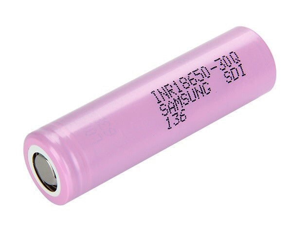

Mine lasted about 30 months, then the battery was going flat 90 minutes into load shedding. I replaced the batteries with these Samsung's. Now it lasts more than 4 hours . Using a fibre ONT, Ubiquity Edge Router X and a Unify AC Lite.
Check this out on takealot: Samsung 30Q 18650 3000mah - 2 Pack
Just by from a Vape shop
Did you DIY the batteries together into a 4x pack?
Yep. I carefully pulled the spot-welded ribbon wires from the old battery pack, then soldered the new cells in. Just be careful that none of the wires touch another one while working...
