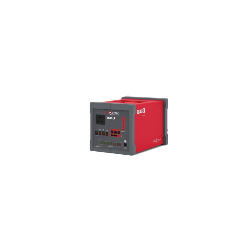

mine is happily running on 12V from Ultralan UPS if you using POE to power other devices you would need to look at power requirements carefully
