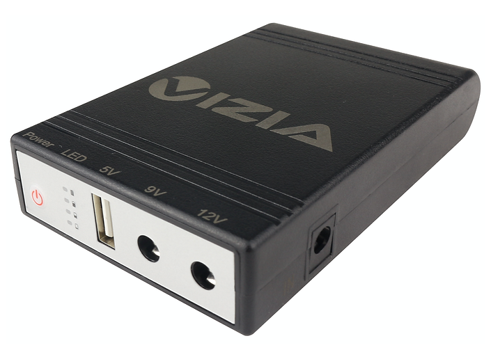

I figured that the cases may be similar while the batteries may differ depending on what the reseller requests the Chinese supply these with. For example Vizia claim they put Li ion batteries branded by LG Chem into their mini UPSes while the same mini UPSes sell for much less on Geewiz under other brands but omit the LG Chem battery mention.

Here is a Vizia unit:

The vizia and the other one on geewiz is both nmc cells
The vizia if you do the math the wh calculation with a 3.7v cell the wh matches listing
ie geewiz one if you take the ah rating
ie (12000mah) thus 12Ax3.7=44.4wh which matches the listing
If it was a LFP/lifep04 the wh would have been 38.4wh

My point was not that LG meant LiFePO but rather that different insides may be present in similar boxes. LG NMC would probably be superior to no-name-brand NMC.
