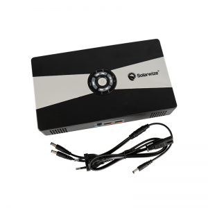

Since I am only supplying 15v? I can try the 24v port on the Mini UPS but I am not scared I will blow the router.If it does not, the RAIN router is being underpowered.
