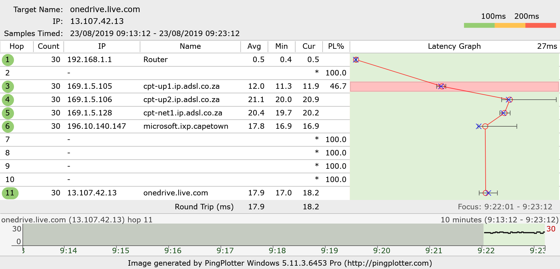

I'm getting <2Mbps to OneDrive for some reason. Speed tests and general performance is otherwise good. This is disappointing considering some recent uploads went at a rock solid 100Mbps without dipping at all, for the first time ever.
The OneDrive web app is at onedrive.live.com. WinMTR to that address looks like this:

I am seeing some packet loss with google.com though, same as indicated initially above:

:unsure:
I believe onedrive has local servers, which implies that 94ms is really high. This is why you are experiencing packet loss. It is very strange that there is a latency issue around that time of the day. Did the situation improve?

no loss, just focus on last hop, pingplotter will give you a better picture.
Just installed PingPlotter. Looks even worse when visualised their way:
Nope. Had to just give up after a few attempts. And can't upload now as it's still rekt.
Ok, please drop me a DM with your B number or clientzone username so I can look into this.
The packetloss on hop 3 is the IPC. I see the same in JHB IPC. It's likely just a device dropping ICMP packets which pingplotter register as packet loss. If there was that much packet loss you would likely not even get 1Mbps. Also packet loss on a line means the packet loss carries to all the hops in a MTR so just seeing packet loss on that hop is not concerning.
