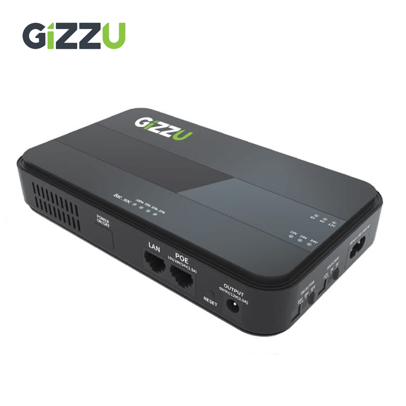

Ratel 860P and an extra DC cable.What's the best solution at the moment for a 9V router and a 12V ONT?
I'm kind of wondering if the 12V unit won't work on 9V. Some electronics are very lenient in that way. I used to power an old 19V Telkom router with a 12V PSU and it worked fine for years.What's the best solution at the moment for a 9V router and a 12V ONT?
It's an Archer C20, and the ONT is Nokia.I'm kind of wondering if the 12V unit won't work on 9V. Some electronics are very lenient in that way. I used to power an old 19V Telkom router with a 12V PSU and it worked fine for years.
Just don't give the 9V unit 12V by mistake, otherwise you'll likely let out the magic smoke.
Does it have a 9v and a 12voutput?Ratel 860P and an extra DC cable.
Yes.Does it have a 9v and a 12voutput?
All over the show. Takealot is a rip-off at R70+ for a 3M DC https://m.takealot.com/lumeno-3-meter-male-and-female-extension-cable-white/PLID41395249Where to find the extra DC cable?
Unfortunately I am battling to find it.Where to find the extra DC cable?
he needs a male to male, not an extension.All over the show. Takealot is a rip-off at R70+ for a 3M DC https://m.takealot.com/lumeno-3-meter-male-and-female-extension-cable-white/PLID41395249

https://m.takealot.com/lumeno-4-way-splitter-white/PLID41395233 will work.he needs a male to male, not an extension.
It does, but because he needs to power 9V and 12V he will need two cables, not the included splitter.https://m.takealot.com/lumeno-4-way-splitter-white/PLID41395233 will work.
More than one way to skin a cat. I assumed the ratel comes with a male-to-male already.

I just spotted this link on OneDayOnly.co.za
8800mAh Black DC POE Mini UPS
Good price
35% off on Gizzu 8800mAh Black DC POE Mini UPS | OneDayOnly
Gizzu 8800mAh Black DC POE Mini UPS available to buy online at onedayonly.co.za, SA's best daily deals site, where EVERY day is Black Friday!www.onedayonly.co.za
Should even out once you include shippingR50 cheaper than Geewiz
