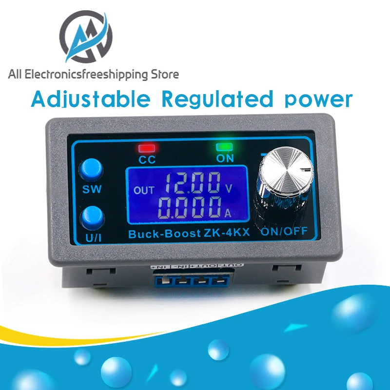

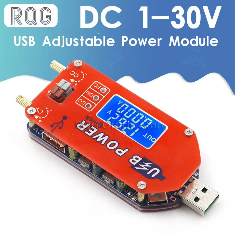

Hi folks,
Anyone got a battery backup solution for 19v power bricks?
TiA
Cheers
D

thanks G
i did read pages back, but guess i'd stop at 51 down to 50...
would this be an ok option for the rain 5g router that has PoE power supply, or should I wait for the 860p ratel...
TiA
Cheers
D
