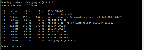

Here's the kicker,
the "capture" picture is running at 56 on the vmg3625-t20a. the "capture 2.4" is running on the 2.4 Ghz band. The "old router" is the TP-LINK TL-WR840N. I ran the test several times to get the best result.
So, after the afternoon of frustrating myself with the VMG router, I have put the TP-Link back. I'd rather have better speeds.
