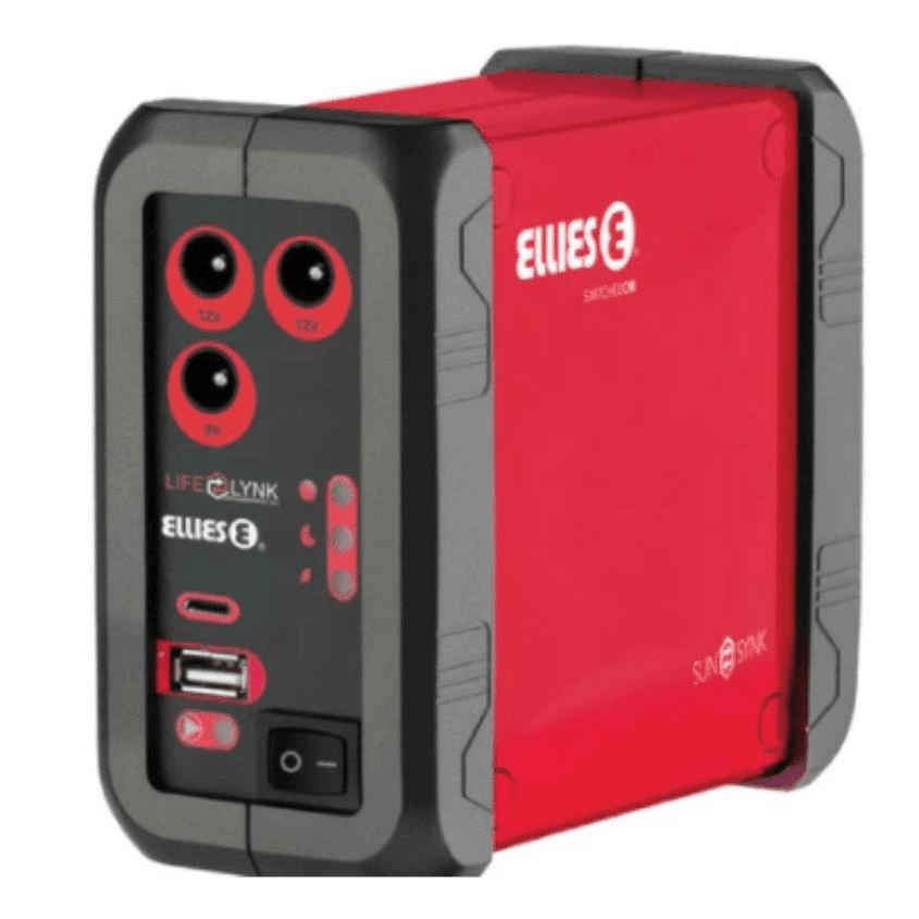

whats better
or
whats better
or
From what I remember, Cube Mini has a ridiculously low output current.
Get the Gizzu.
whats better
or
What do you want to power?
and how long does it last ?
Depends on what you're trying to power.
Also, if you're saying you need to power more than one device (router+ONT), it might not be up to the task due to the low output current I mentioned before.
